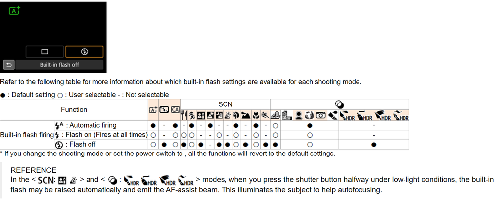

What mode are you using on the mode dial. In the creative zone ie (M, Av, TV & P) modes the flash can be disabled. But the AF Assist Beam from the built in flash will still work.
05-25-2023 03:43 PM
its the auto mode
05-25-2023 04:55 PM
Are you using Green Square Auto or Creative Auto Mode. Flash can be disabled in Full Auto Mode.
05-25-2023 05:04 PM
the internal flash is set to auto on, i tryed setting it to on also, but same thing, it flashes for focusing, but not when taking the picture
05-25-2023 05:08 PM
Are you letting the built in flash recharge. When the built in flash is recharging the camera reports "busy". Heavy use of the AF Assist Beam will cause the built in flash to discharge quickly. With the lens set to MF. NOT the camera set to "M" mode will the flash fire. With the lens set to MF the AF Assist Beam won't fire. Manual Focus requires you to focus the lens. This is just a test to see if the built in flash is being discharged quickly when the AF Assist Beam is being used.

Wireless E-TTL flash can't be used in Full Auto. But Flash Firing can be turned off in Full Auto (Green Square). Also the EL-5 supports ONLY radio transmission. Even though "RT" IS NOT in the name. It also can't be used on camera with certain cameras. But it can be an off camera receiver speedlite.
