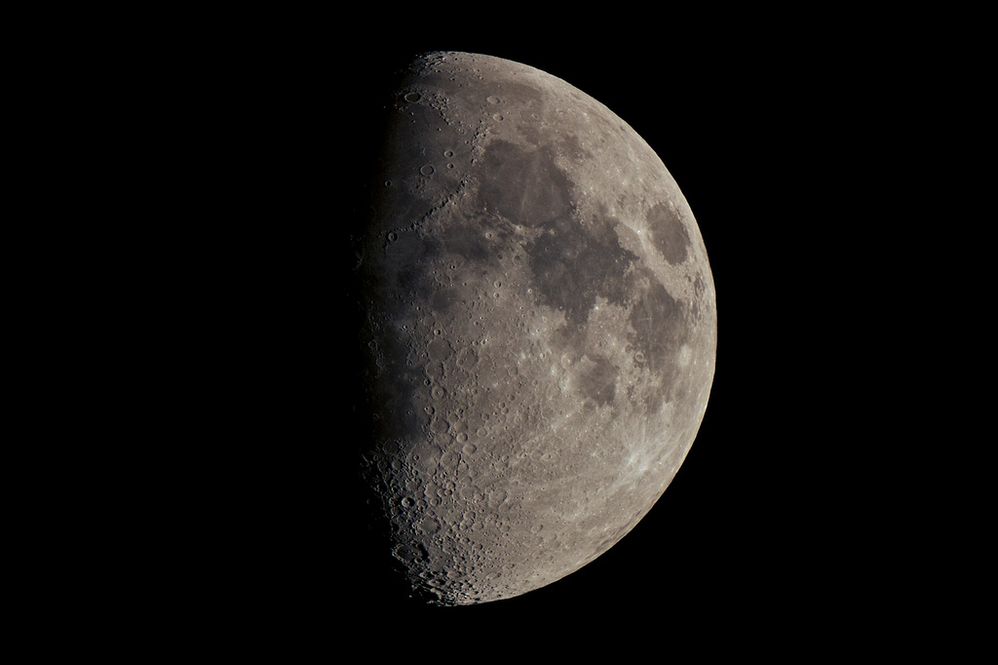

This image was taken with a Canon 60Da following the "Loony 11 Rule" -- but rather than a 300mm lens, I'm using an apochromatic refractor.  This image is effectively like using a 960mm lens at f/12 (which is within 1/3rd stop of f/11).
Moon
Ordinarily, you *should* be able to use the "Sunny 16" rule to photograph anything illuminated in full daylight (and the moon is in full daylight).  So a "Loony 11" exposure is technically over-exposing the moon by a full stop.  But that's because the moon is exceptionally poor surface "albedo" (it's reflectivity) -- which astronomers compare to being roughly the reflectivity of a black rubber tire.  So basically we are deliberately over-exposing it to get something that resembles a "correct" exposure.

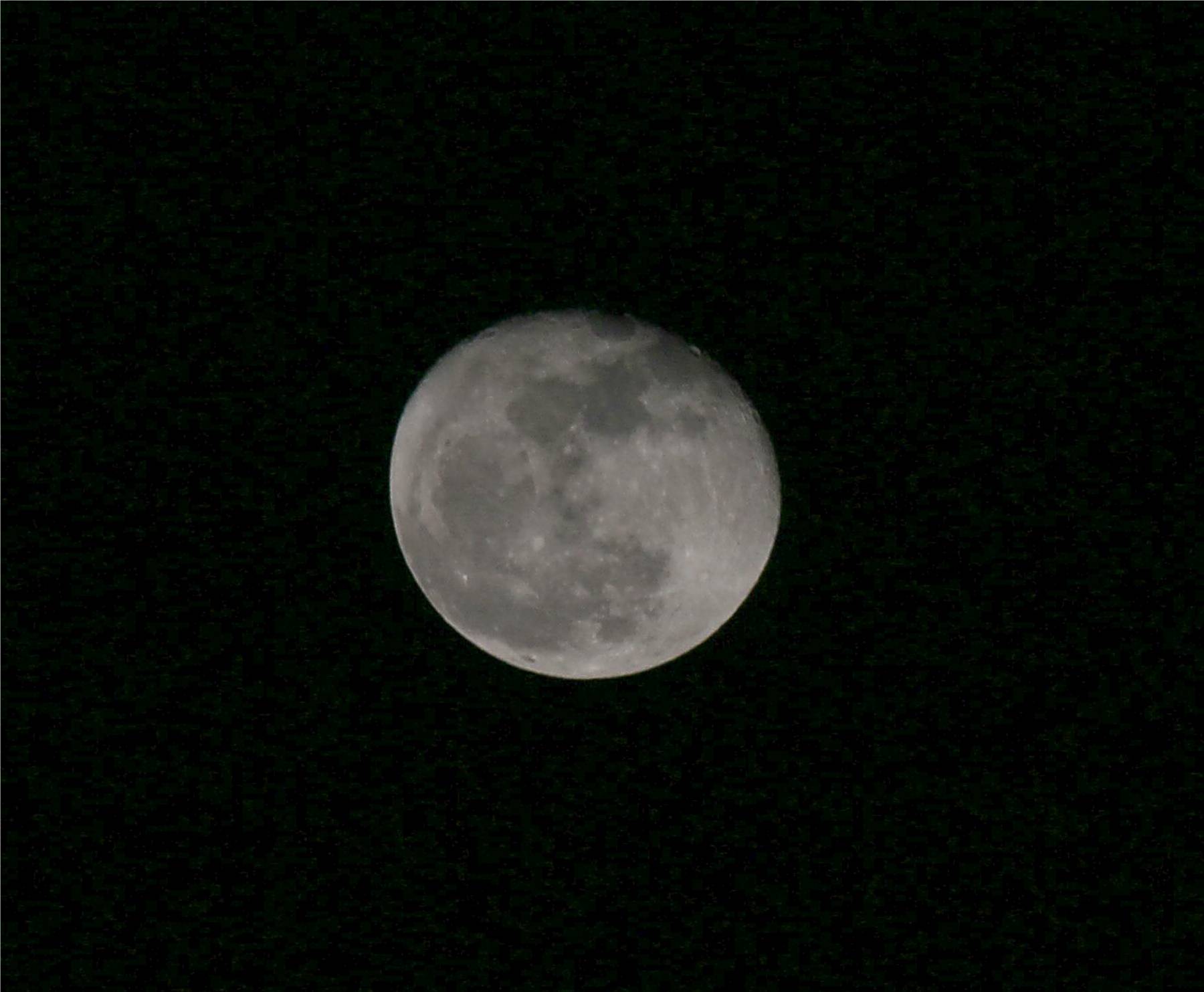

_MG_5458a.jpgThanks for all the help.  Following the first suggestion, I was able for the first time to get a clear picture of the moon.  I've been trying to do that forever it seems.  Guess I should have just asked you guys sooner.  Well, problem solved.  Thanks again.
And that is a very respectable image of the moon!  Well done!
Tim Campbell
5D III, 5D IV, 60Da
Very nice!  In addition to a nice capture, there's nothing like the satisfaction of finally figuring out something that has been giving you trouble.
I don't know if that noise in the sky bothers you or not.  Any decent noise-reduction program would be able to smooth that out considerably.
Yeah, it's great to finally figure that out.  I know I've been trying to capture a picture of the moon for years with no luck.  Got a lot of on-coming trains at night though.  The noice in the skiy doesn't bother me.  It actually makes it look more like outer space.
