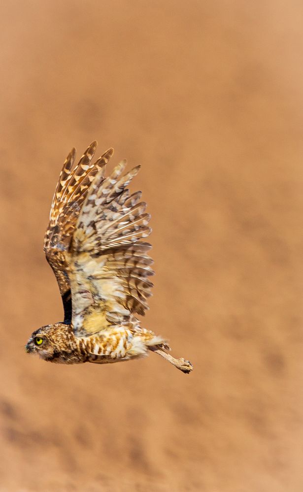

Was out today practicing with the new AF settings. It is still very difficult to have the camera lock onto subject while in flight. I am using the AF-On button for AF with Eye detection for animals but when they are moving fast it doesn't keep locked. So would I use my Spot Focus extended area with the star button and hold it down or just single press? I am also wondering with the AF--On do I keep it pressed down for the entire shot or just hit it once then done?

What were the ISO, shutter speed and aperture for the image of the BIF? Also, is the first image cropped or did you shoot in a vertical orientation? How far were you from the subject and it looks like a beach or desert, what was the temp?
Did you download the DPP software to view your focus points. The wing tips look sharp in the first image.
The second image looks pretty sharp.
