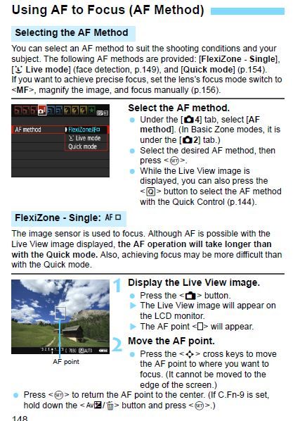

Robbins,
You stated that your T6 "won't focus propoerly when using the LCD screen". If you've done it before, a setting may have been changed that is causing the problem. It's always good to do a "Reset all Camera Functions" and start over setting up the camera functions for your preferences.
If that doesn't work, then perhaps the following from the T7 manual might help. (I have a T7 and I think there are some minor differences but the controls are essenially the same). You can download the manual for the T6 from usa.canon.com, and look for "Support" and put in you camera model to search.
In the manual for the T7, Chapter 5 - Shooting with the LCD Monitor (Live Shooting) I found:
Good luck!
LZ
