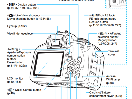

When you are not taking pictures what do you see on the LCD screen at the back? It is black or is there a display of some kind?
If it is black, I suggest tapping the DISP button wait, and see what happens.
Another thing to consider, given you see a brief display of the image, also look at the Live View button - see:
I suggest having a look at the manual for the page references given in the diagram. If you have not got it, download it from this link:
eos-rebelt100-3000d-im1-en.pdf (c-wss.com)

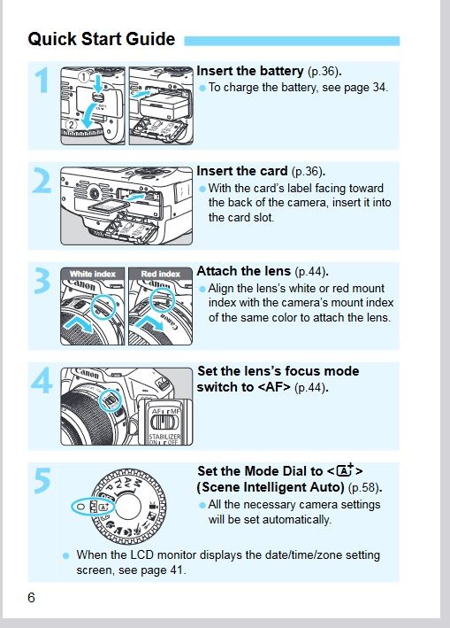

08-08-2024 12:22 PM
Follow these instructions from your manual:
