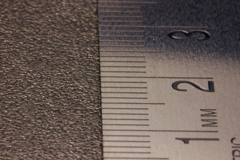

As other have pointed out... when you get REALY CLOSE to a subject, the "depth of field" starts to become very narrow -- almost "paper thin" (especially if you use a low focal ratio).
Here's an image taken with a 100mm macro lens at f/2.8, but at very close focusing distance.  You can see that my "depth of field" (the range of distances at which things appear to be in acceptable focus) is just a few millimeters wide.  You would probably not be happy with an image of a flower taken at this focal ratio because very little would be focused.
Here's the same subject, same camera, same lens, same position, but this time I'm using f/32.  You can see that nearly everything is acceptably focused.
