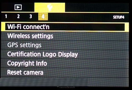

I have gone through the menu items that you shown in the screen capture. There is no place to turn off the WIFI. The Wi-Fi connect'n menu item is the menu page the Wifi button will bring up if you press it. To make the matter worse, once it went into the Wifi connection menu, the camera won't go into sleep mode and it will drain the battery until it is dead.
