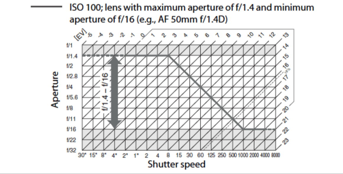

Switch ISO out of Auto.  Set it to 400.  Program mode follows a specific exposure "program" formula to determine the exposure settings.  It is always possible that Canon changed the curve, but I seriously doubt it.
BTW, your threat to buy a Sony is laughable.  You're not the first person, nor the last, to do that.  "If I don't get an answer, then I will go buy a Sony."  Go for it, I say.  If you're getting rid of your Canon, what is the point in continuing?  Let's end this discussion Here and now.  It is your call.
This is how Program mode works.  The exposure settings will always fall somewhere along that dark line.  Note this curve is for ISO 100.  Different ISO values will follow the Exposure Triangle to come up with new exposure settings.C2E93C07-C47C-44F6-9FE0-03972CDE6BD7.jpeg

Okay.  And the very moment that you press the shutter to start the metering system at the new location it changes.  Your previous settings are now gone.  This is not a bug.
