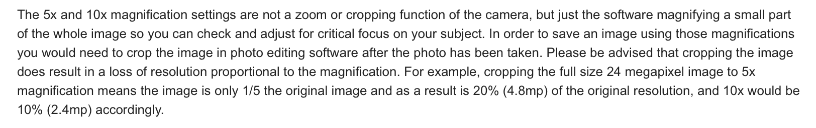

Thanks to all who responded to these two problems. Attached is an evaluation from Canon Support. Looks like I'll have to rely on my microscope to resolve magnification issues rather than the T6s or its utility software. Mike

I see you are on your way to resolving your questions. I see Canon used almost the same language that I did to explain the magnified Live View settings. Users who are accustomed to smart phones and other devices with optical zoom are often misled by the magnification setttings.
BTW, the camera can only capture an image when you are manually focusing. Any focusing issues that you are having reside solely with your manual focusing lens, which in this case DOES mean your microscope. The manual focus lens is solely responsible for any and all focusing, be it good or bad.
