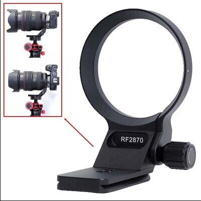

If, on the other hand, you have a need for the camera plus lens mounted on a tripod, for studio or convenience, then my research indicates that Canon does not, itself, make a tripod mount; but do a search on Google for "RF 28-70 lens bracket holder" and you will come up with some 3rd party offerings for this lens, for example:
I hope this resolves your concerns!
