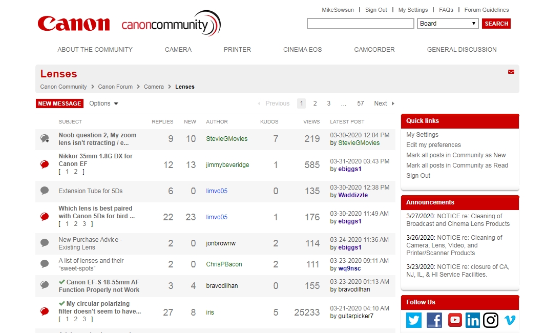

To post, just go to one of the board names like "Lenses" or "EOS Rebel" and you will see a box called "NEW MESSAGE" in the upper left corner.
