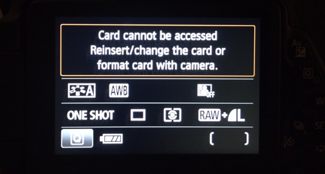

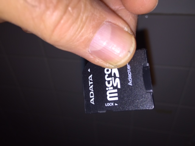

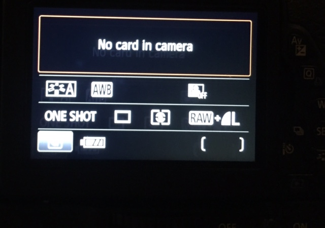

I have a T5i and on several ocassions this has happened now to me. After re-inserting the card it clears. I believe in my case the cause is the small switch that is actuated by the SD card while inserted. Without viewing the logic diagram of this circuit I can not be 100% sure but it would appear this is a permissive and is the cause for the message in my case. To prove this I inserted a Micro SD card adapter with NO Micro SD card in it see photos doing this yielded the message "Card can not be accessed..." If I close the SD card door with NO card inserted the message displayed is "No card in camera".
So the SD card sense switch appears to be the root cause of this issue well at least in my case that is.
As far as fixing it you would have to locate the switch to see if it is hanging up due to dust/dirt and that would require some technical skills.
BTW I am an electrical/electronics technician though I don't work on cameras rather power plants.
Bob

You are  correct. Due to the second set of contacts in the Micro SD card adapter a high IR condition or open can rear it's ugly head and cause issues loss of data and such. In this instance I was using the Micro SD card adaptor as a troubleshooting aid hence no micro SD card in the adaptor.
