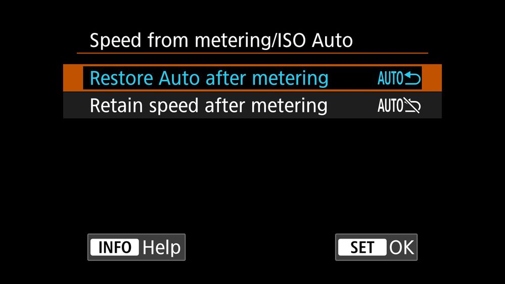

With my camera set to M on the mode dial and auto ISO. I can turn the quick control dial 2 to change the ISO, and this also moves the exposure compensation slider. However you will note that the in the box on the lower right of the screen the word AUTO which is small under the ISO text will be shown in grey, not white. In effect you have temporarily changed the ISO to your chosen value, but since you were originally in auto ISO then the camera is ready to switch back to auto ISO. This switch back to the auto ISO and no compensation occurs when the metering timer ends or you take a shot.
This behaviour is the default, but can be changed. Go to the custom functions menu page 1 and select the third entry, Speed from metering/ISO Auto, and change it to retain speed after metering.
Brian
I made a few screen captures from my camera to show what I see...
First screen is the camera in M mode and auto ISO. It has metered the scene and determined that it will need ISO 3200.
Second screen shows that I have turned quick control dial 2 to increase the ISO to 6400, and then the camera indicates this will be a +1 stop overexposure.  You will also see that the word AUTO under ISO has turned grey. If I wait for the metering timer to complete the camera returns to auto ISO and next press of the shutter to meter shows ISO 3200 again and no overexposure indication.
As I said above there is a setting in the menus to change this behaviour. If you change your camera to retain speed after metering then it will stay with the same ISO settings until you change them.
