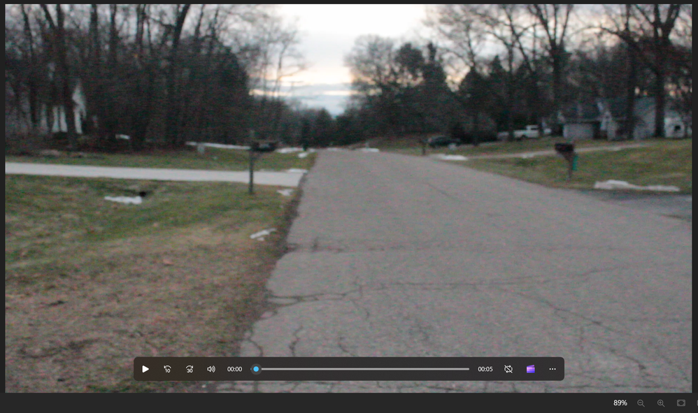

This is what it looks like on the video setting, which I am most concerned about since I bought it for making short films. Do you see the reddish graininess?
02-08-2024 07:19 PM
That's color noise. There's also cyan and green in there along with the red/magenta.
What lens are you using? And what are the settings for your videos? In terms of shutter speed, it's typically best to use half of 1 divided by the frames per second value. e.g if shooting at 30 fps, set the shutter to 1/60 s.
The sunny 16 rule though states that a decent exposure is around f/16, 1/100 s and ISO 100. In this scene, it appears you're in either sunrise or sunset, so if the aperture is around say f/8 or even f/5.6, there should be enough light to keep your ISO low.
Having said all of that, it could just be that the T3i just cannot capture good quality video. Notice the softness in the frame of what you provided.

Canon EFS 18-58mm lens, AWB auto, Raw+IL, 24ps, ISO 6400. So, is this a fixable problem, or should I just return it?

I read several articles that recommended that you not exceed an ISO of 1600 on a Canon T3i.
You can do a Google search for "Best ISO for a Canon T3i", and you'll see what I mean.
At 6400, the noise is pretty bad.

The video would definitely not be RAW. The "RAW+L" that you listed is referring only for Photos.
Agreed with Steve in that ISO 6400 will lead to a very high amount of noise. What shutter speed and aperture were being used for this video? Perhaps the shutter speed was too high or aperture to narrow. That would explain why the ISO was so high.
