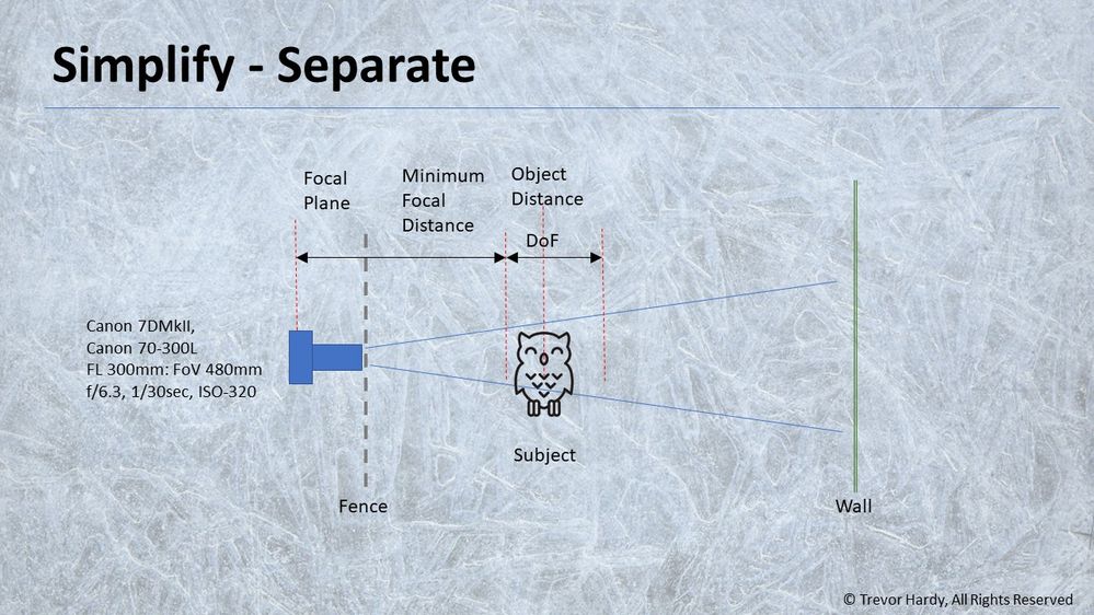

It is important to remember these three elements that impact DoF:
1. The closer the subject, the shallower the DoF
2. The longer the lens focal length, the shallower the DoF
3. The larger the aperture (or smaller the f-number), the smaller the DoF
Given these mantras, if you want to eliminate the fence, you need a long FL, be as close as possible to it and use a fairly shallow DoF.
This below was taken with a Canon 70-300 lens through a fairly thick wire netting enclosure - you can see that at the far end of the enclosure.
Canon EOS 7DMkII, EF 70-300L @ 300mm, f/6.3, 1/30sec, ISO-320
So, in this shot, I applied all of the above principles. I used a FL of 300mm (equivalent to 480mm), the largest aperture possible and went right up to the netting to place the netting within the closest focusing distance.
Using a short FL (e.g. the 18-55) is going to be challenging to avoid getting the netting out of focus, especially if you are not right up against the netting.
To give an idea of the effect of ONLY reducing the lens FL, the following two images were taken with the Fuji X-T4, and the Fuji 16-300 f/4 lens. Both were shot with the following settings: f/6.4, 1/900sec, ISO-320 and I was only cm from the wire matrix
The one immediately below was shot with a FL of 18mm;
As you can see, the wire matrix is clearly visible in the image.
Standing in exactly the same spot, I took this shot at 78mm
Now the wire is not in view, yet the angle of view encompasses where wire would be. The difference is that the minimum focus distance has shifted to a point beyond the wire.
