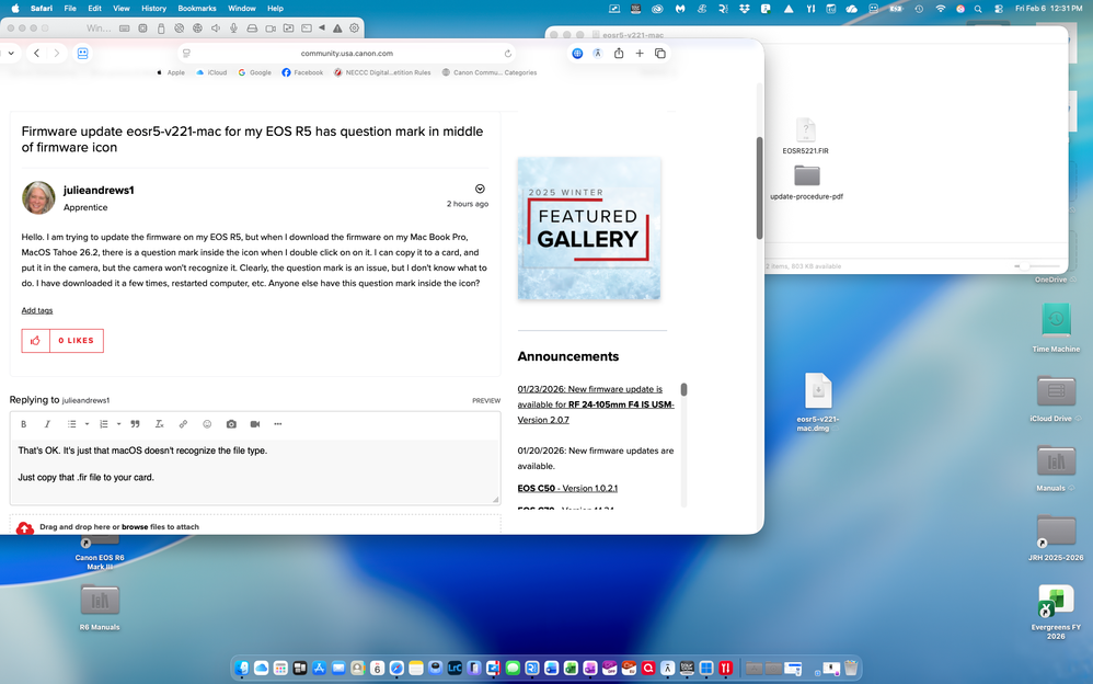

Hello. I am trying to update the firmware on my EOS R5, but when I download the firmware on my Mac Book Pro, MacOS Tahoe 26.2, there is a question mark inside the icon when I double click on on it. I can copy it to a card, and put it in the camera, but the camera won't recognize it. Clearly, the question mark is an issue, but I don't know what to do. I have downloaded it a few times, restarted computer, etc. Anyone else have this question mark inside the icon?

That's OK. It's just that macOS doesn't recognize the file type.
Just copy that .fir file to your card.
