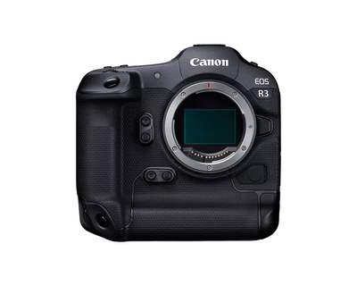

11-22-2022 10:52 AM - edited 12-19-2022 12:38 PM
EOS R3 Firmware Update, Version 1.3.0
