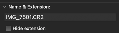

Thanks to all == I am now in Monterey OS and downloaded files from iCloud [they come in as zips] and expanded the zips and have them come in as a plain icon, and if I get Info there's no CR2 or 3 attached == but the jpg of the image shows and the images without the extension still show up in column view.. I decided to test adding CR2 to the image and that solved the problem ===I"m hoping I can use Automator to do them all, or I'll do them one by one == thanks much for the help and discussion [I'm not moving to Ventura just yet]
03-20-2023 02:54 PM
Are you absolutely sure that those files are missing their extensions? Note that Finder on macOS can be instructed to not show file extensions for particular file types.
If you have to manually add .CR2 or .CR3 to the files, I fear that you'll end up with files named like "IMG0001.CR2.CR2".
03-20-2023 03:22 PM
Yes - I did a get info and I have Finder set to show all extensions = they changed to IMG_####.CR2 -I'll double check next time I'm in Monterey....right now I'm back on Mojave. Thanks
