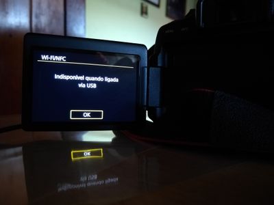

While the USB cable is connected, the camera also recognizes that it is connected to something. The visor opens normally, as it's not connected, but whenever I press any button, it shows the "BUSY" message. After a few seconds, I can operate the camera, and, navigating through the menus, the WiFi options are grayed out. I can take pictures normally, as if it's not connected.

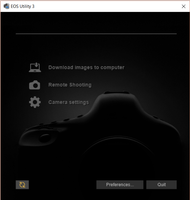

Eos Utility not recognizing the camera:

Camera visor Info:
