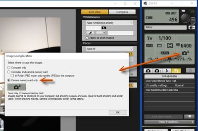

@Blaine wrote:
How did you store to the card?  When I tried to set my folders or setting to save to an SD card I don't see any option for that, only to DL all images or to DL + save to card.
To start with, I didn't use EOSU and just used the utility that came with my Wemacro rail. It automatically stores your stack on camera. Don't bother looking in the Wemacro utility, it just does it by default.
As for EOSU, version 2 and 3 both allow you to set d/l and folder options. If it's not showing, it could be because you have the macro rail in the mix.
