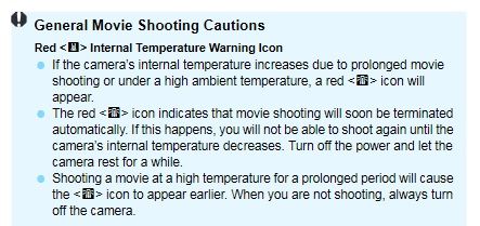

Did you stop the clip at 12 minutes, or did the camera? If it  had reached the 4 GB limit, you should be able to start it again. Did you see any temperature warnings?
