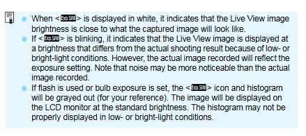

09-01-2023 02:27 PM
It is simply saying that what you see in live view is not what you will see in the image:
