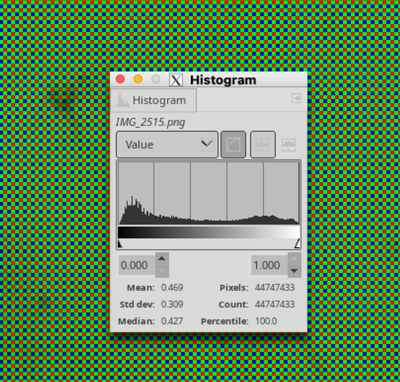

I attached camera to light box and made 2 remote triggered photos. First with ALO enabled and second with ALO disabled in camera menus. I used one of the example programs that comes with libraw source code to make a viewable image of the raw data without any interpolation.
Notice that the histogram of the raw data is different when ALO setting is changed in the camera and nothing else is changed. The darker end of the histogram is changed the most.
Changing the ALO setting in the camera changes what raw file will be produced if any of the exposure settings are auto.
