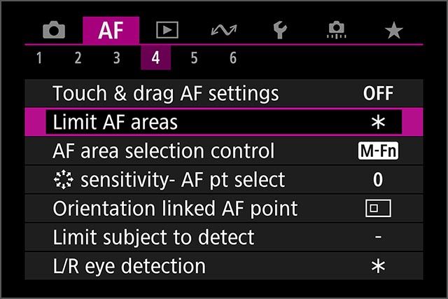

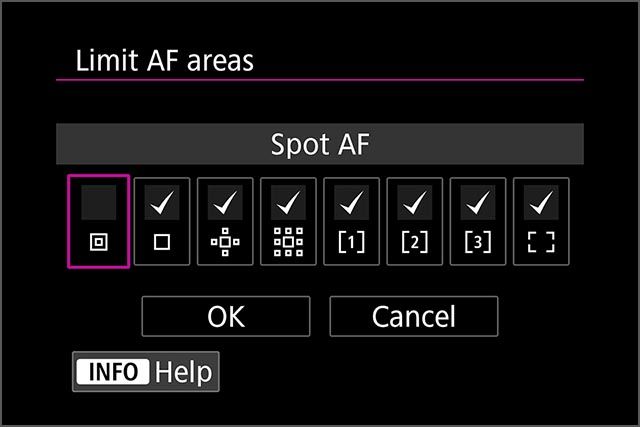

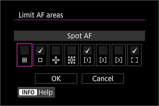

This sounds like you have limited the selectable AF areas.
I'm assuming that when you go to select the AF area the display looks like this one, with the spot AF option greyed out to the left of 1-point AF.
This is the screens from my EOS R6 Mark II, but it is very similar to the EOS R8 menus. If you navigate to the option to Limit AF areas, you can then choose which AF areas are accessible. Firstly if there is an asterisk shown, then it means some AF areas are not selectable. I am pretty sure yours will look like the second screen with no check mark above the spot AF point.
EOS R6 mk2 AF area not selectable 2.jpgEOS R6 mk2 AF area not selectable 3.jpg
For my camera I choose to only use three of the AF areas for almost all my photography, so mine looks like this. And then below is the corresponding display on my camera with only those three choices available. I do this since it means I work with the AF areas that work for me and the way I shoot, and also not only does is avoid me using one of the less suitable areas, it's much faster to change between my preferred options.
