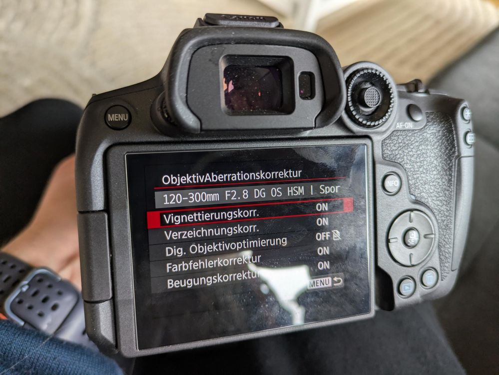

signal-2026-02-06-140953_003.jpegHey there, i just made an account to post my experience over the last month.
I just solved this exact problem - my 120-300 f/2.8 Sports had the same issue (Err 01, no AF, no aperture, no IS on R7, but worked fine on R6 and RP).
The Good News: It's Fixable!
This is a known issue affecting certain older 120-300 Sports units, particularly those with pre-Toshiba CPU serial numbers. It's NOT a general R7 compatibility problem - it's a unit-specific communication error.
What I learned:
  • Sigma Japan personally tested the same combination and it worked fine
  • Multiple users worldwide have reported this (Germany, Korea, USA forums)
  • Sigma has a special firmware calibration that fixes it (NOT available via USB Dock)
What You Need To Do:
  1. Contact Sigma support in your region with:
    • Your lens serial number
    • Symptom description (Err 01 on R7, works on other bodies)
    • Mention this is a "known R7 communication issue affecting older production units"
  2. Send it in for service:
    • They'll apply the special firmware update
    • Can't be done with USB Dock - requires service center equipment
    • Takes about 1-2 weeks
  3. Result:
    • My lens came back working perfectly
    • AF, aperture, IS - everything functions flawlessly now
Key Points:
This affects certain units (especially older serial numbers, there was a switch to Toshiba CPUs)
Sigma is aware and has the fix
Requires service center firmware calibration
After repair, works perfectly on R7
Don't give up on the lens - it's worth getting fixed. The 120-300 Sports is fantastic, especially on the R7 with the crop factor for wildlife!
Happy to answer questions about the process. Good luck! 📸
