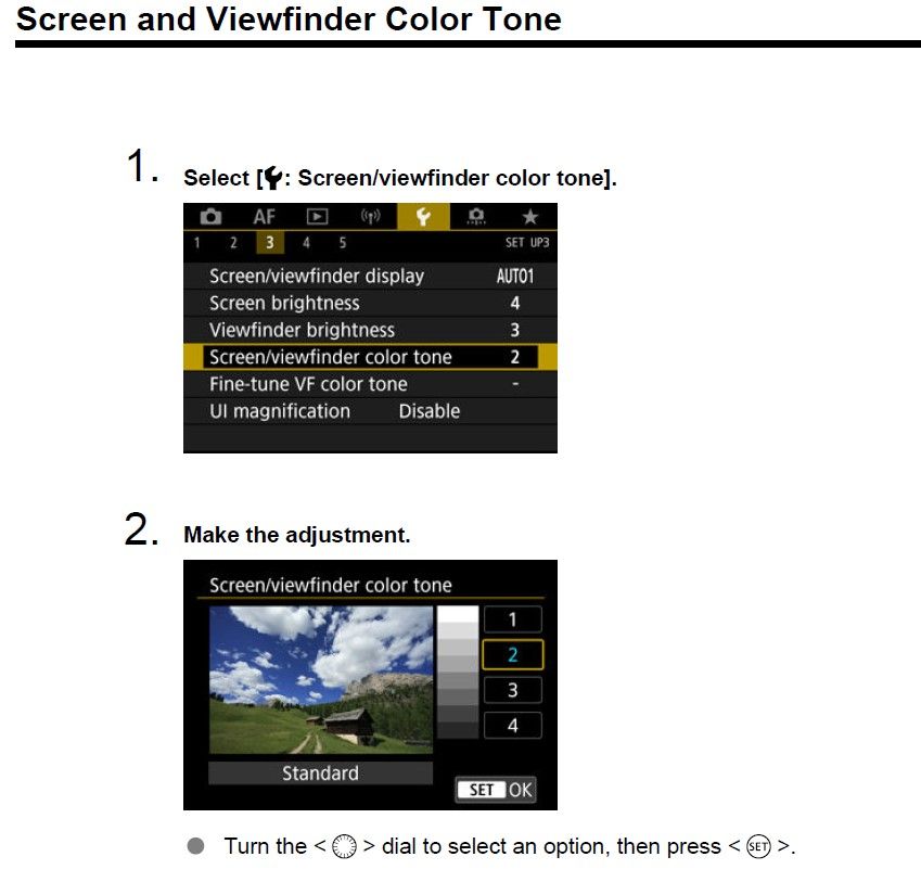

You can adjust the screen and viewfinder color tone according to the manual.

I edited my post above to show how to adjust the screen and viewfinder color tone.

Thank you so much for this! I checked what mine is at, and my color tone is also at 2 already but my brightness is on auto. Would correcting that help the fact that my photos look great exposed in camera and then they look not so exposed and great in post?
So, for the fine tune VF color tone, do I do that manually every time? Or is that something I set up and it stays that way? I only have this issue with indoor photos, my outdoor photos I can get spot on in Kelvin and they look like that in post as well. It's only these ambient lighting situations that seems to be so different from camera to post. So if I adjust that when I'm indoor will that also mess with my color tone for outside?

Anonymous
Not applicable
First, I would try Auto White balance (AWBW), then set the viewfinder and screen color tone and go with that for a bit. Whatever you set the color tone to will stay for any shot, indoors or out. You shouldn't be constantly adjusting it, once you get it to your liking. The viewfinder and screen will not always match what you see on your computer screen, unless you calibrate both to a standard. It is normal to not match exactly.
