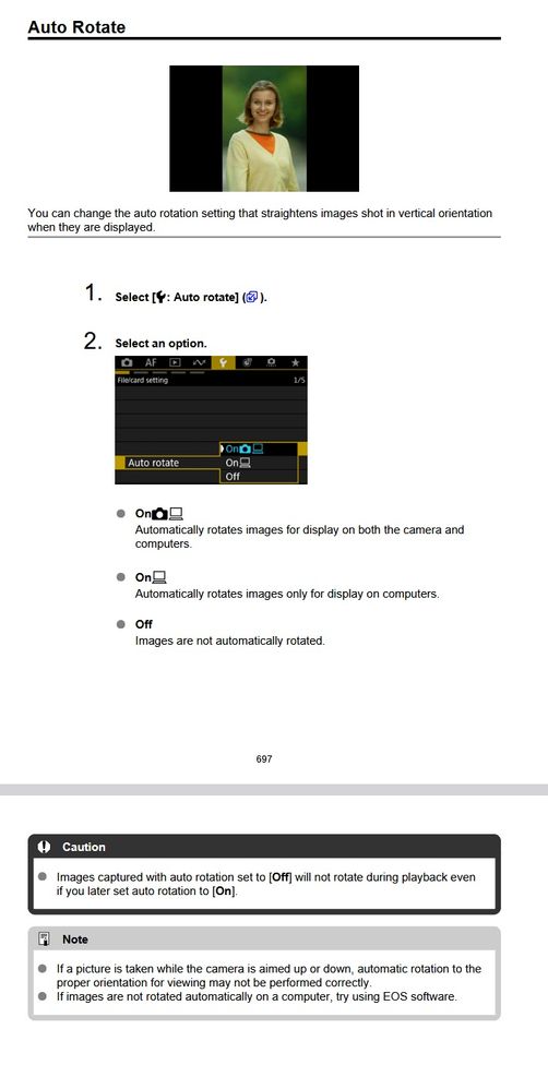

Turn Auto Rotate "Off"
03-25-2026 07:24 PM
Good idea. I had suspected that the camera didn’t know which direction it was pointing. I think the sensor is inside the rear flip out screen.
