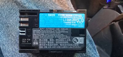

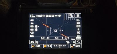

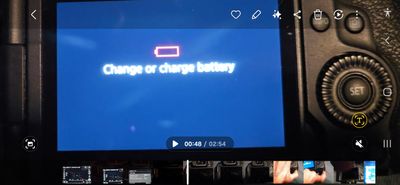

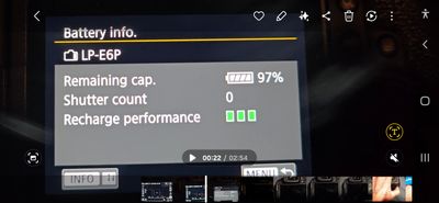

01-21-2026 09:51 AM - edited 01-21-2026 10:06 AM
I encountered this precise issue this morning, January 21, 2026.
Upon powering on the camera with fully charged batteries, I received a "dead battery" message. If I remove the battery while the camera is still active, I can then access the camera's functions. However, after turning the camera off and then back on, it indicates that the battery requires charging.
Video Link:
Is it the batteries or the camera that's the issue?
***Update***
This issue appears to be related to temperature. This morning, in New Mexico, the ambient temperature dropped significantly, and my batteries were charging on the dashboard overnight during camping trip. Once the vehicle reached an optimal temperature, the problem resolved itself.
