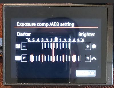

I do residential photography for real estate. I shoot brackets of 5. Whenever I have a bright window that has to be in the center of the shot the light metering only seems to recognize the center. It doesn't matter how it is set, I get the same result. I can see out the window but nothing in the room I'm shooting. Anyone that can shed some light on this would be greatly appreciated.
08-24-2025 04:23 PM
No, What I am saying is that if I have my center focus point on a darker area of a room the picture is fine. If I change and center over a bright window all 5 are underexposed even if I move the focus point to the edge of the frame where it is darker. This happens in all metering modes. I use 3rd party software to merge them, It's not the software.

I would expect that they would, ranging from way under to way over exposed. He has said that he cannot set the camera to achieve the range he wants. And then posts an image showing the setting is possible.
