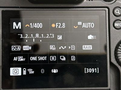

I do residential photography for real estate.  I shoot brackets of 5.  Whenever I have a bright window that has to be in the center of the shot the light metering only seems to recognize the center.  It doesn't matter how it is set, I get the same result.  I can see out the window but nothing in the room I'm shooting.  Anyone that can shed some light on this would be greatly appreciated.

C3 AV mode all shots taken at F8 and ISO 400. 5 shots the center at -2/3 then -2 2/3 and so on for both + and -. Evaluative metering but that doesn't matter I can change that and it's the same result in all metering modes.
It doesn't matter, I get the same result with all of them.
I might also mention that this didn't happen with my 5D Mk 4

It's set to Expand AF area: Around.  If I move it to outside the bright area it doesn't change anything. Yes it's on a tripod.  Setting entire exposures manually isn't feasible.  It does vary the shutter speeds, just not enough.
