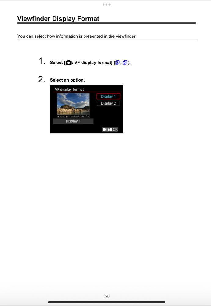

There seems to be no way to get the same "clean UI" in the Viewfinder (unless I missed it)
The "Basic Shooting info" always appears in VF and can't be removed.
Given the smaller size of the VF a clean Ui is very much needed, more even than for the screen.
The feedback for the Canon team I give is to let us also remove the "Basic Shooting info" when customising "Viewfinder Shooting Info"

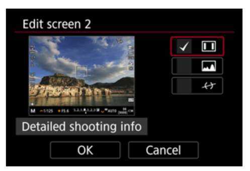

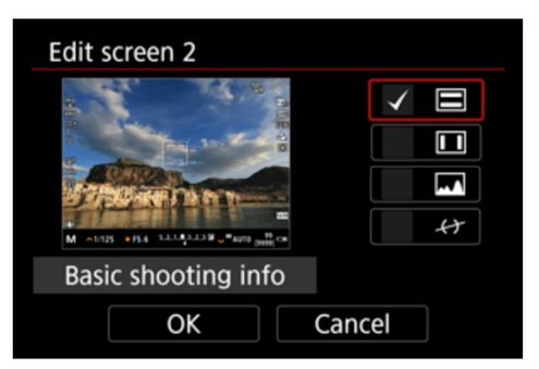

Current VF Shooting Info customisation options:Current.png
Desired VF Shooting Info customisation options:Desired.png
Viewfinder Display Format n°2 is not helping solve this issue at all.
I have everything unchecked.

This is what I see in the EVF (using Canon manual example) when metering expires.Screenshot 2025-10-05 at 14.43.19.png
"Basic Shooting Info" is still Visible and is taking up a % of the EVF surface/space/pixels
This is what I need to have in EVF (this result I can get in "Screen")
So no "Basic Shooting Info" no icons in the EVF when metering expires: 100% of the surface/space/pixels of the EVF screen shows what the lenses is seeing.
As for "Screen" the icons in EVF should appear ONLY when metering active.
If this is doable then how?
