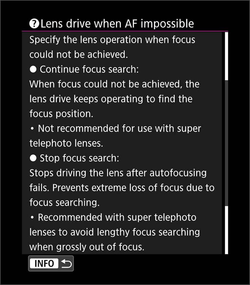

The setting you are seeing is a sub level of the Lens drive when AF impossible. This setting has two options ON and OFF. When you press set to select one of these, then the two choices are expanded to show  Continue focus search ON and Stop focus search OFF. You can either choose the stop focus search or continue focus search they correspond to the OFF and ON respectively.
Lens drive when AF impossible setting determines what the camera does when it was tracking a subject and then loses it. With continue focus search (the default) the camera starts driving the lens over it entire focus range to try and find a subject. With stop focus search the camera does not move the lens, and you have to lift off the focus button and press it again to start it searching.
Here's the screen grabs from my EOS R6 which has the same function and menus here. Pressing the INFO button displays the help for this function.

EOS R6 lens drive when AF impossible info.jpgEOS R6 lens drive when AF impossible info.jpg
