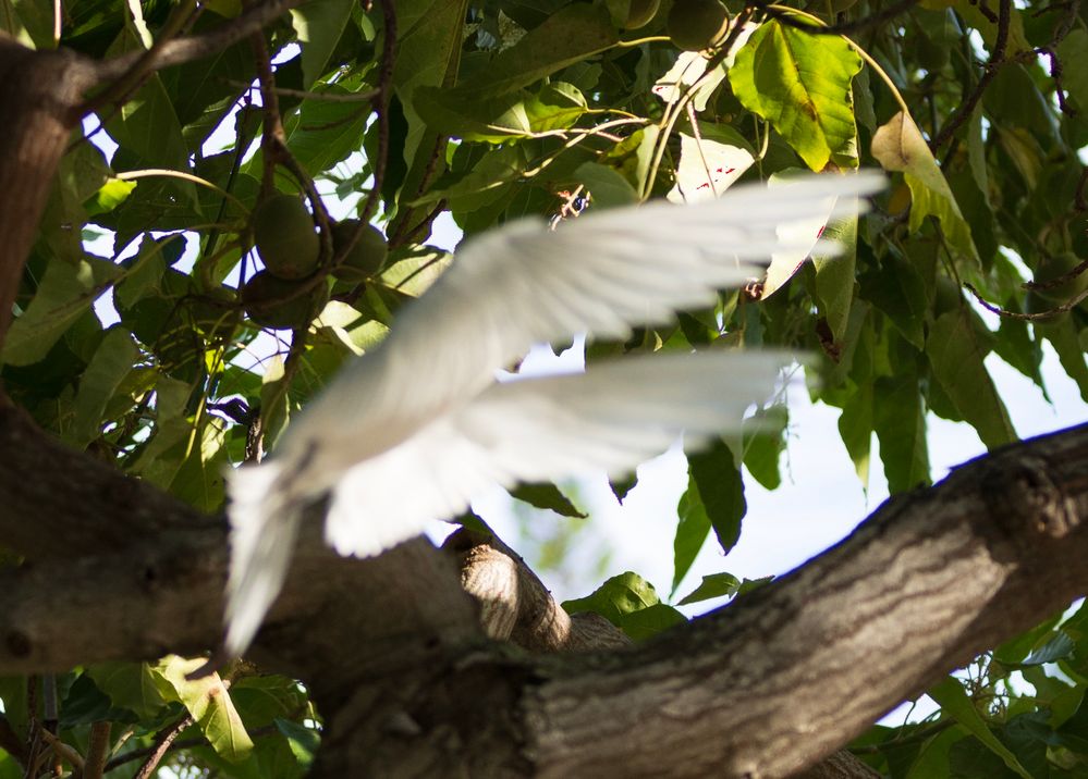

But when the terns fly in and dance about above my head in the canopy, I get hundreds of well-composed blurry photos. Very frustrating.
I'm shooting TV with 1/1250 to 1/1600 shutter speed. Using the 70-200mm lens.
The problem is clearly the focusing. The R5 can't find something in the terns' plumage to focus on.
I've tried a variety of AF options, but no luck so far.
I'm attaching a typical (screenshot) of the type of photo that gets trashed!
Honestly, I think I did better under the canopy with the 80D.
Any thoughts would be gratefully received!
Cat

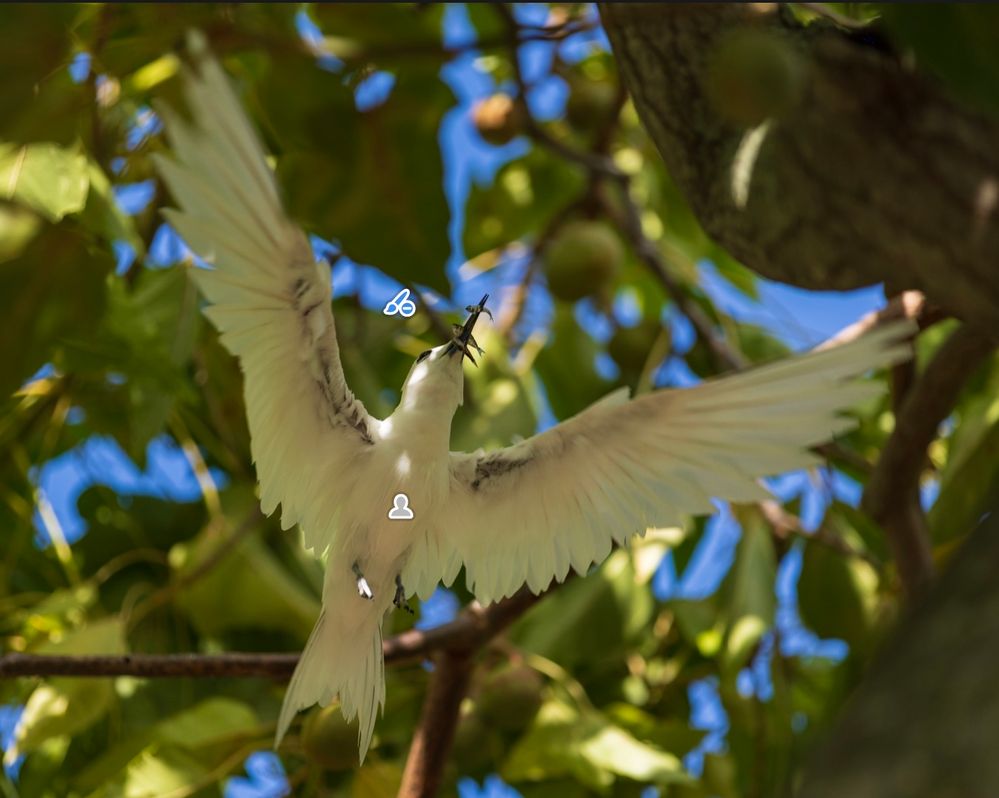

While the eye locator had difficult, even with a tern sitting on her egg, the zone setting got a parent delivery fish nicely! Screenshot:
So my question to you is: What is "keep it simple" shooting a bird over your head under the tree canopy?
My (today's experimental) shoot would suggest TV 1/16000 / Animal / AF Zone.
Takk!
Cat

While the Zone didn't seem as good as a multiple point when I'm shooting a tern against a blue sky, I did get a number of great shots in the canopy. Screenshot:
Question —
I found the animal / eye settings frustrating.
Even with a mother tern sitting on an egg, the R5 had real difficulty finding the eye.
When it did: crisp!
What's your method for getting the focus to, say, target the bird's head so the eye locator has a better chance of (quickly) finding the eye (in conditions such as the tree canopy)?
Takk!
Cat
