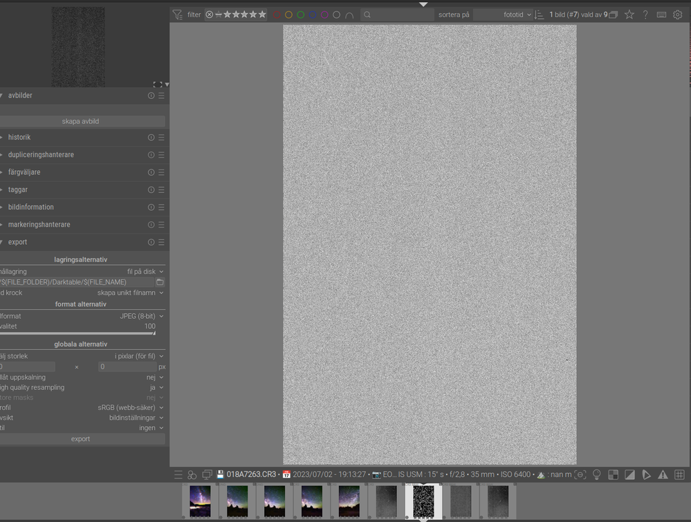

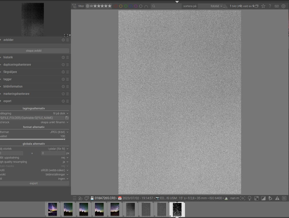

07-03-2023 04:35 PM - edited 07-03-2023 05:34 PM
For your two first pictures without lens cap I meant real night pictures of the sky, so try with and without LENR next time you get out there. A bonus is that LENR will clear out those 400 bad pixels but double the exposure time.
It seems you catched a muon in you xxxx63 file.
I increased the brightness by 7,5 EV to make it stand out, but it is visible at 4 EV. Take a look at the thumbnails. LENR (or a dark frame you later use) solves it.
A dark frame should be taken at the same time and temperature, but if I were you I would try to use your XXX65 dark frame together with your astro pictures with 15 seconds exposure and ISO 6400.
Enough said about dark frames and LENR. I have seen a sensor factory calibration with a 550D to reduce fixed pattern noise. I don't know if it is possible to do something similar to R3. You should call Canon and ask. If you find any other R3 owners you can ask if their R3 sensors behave the same.
