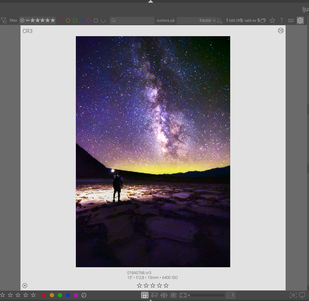

In your first picture you got both top corners green. I get just right one in the raw file you uploaded.
Could you please upload the raw file from your first picture here also? I am asking because you have the Milky way at a different place and more to the right corner there. Also the green corners in that picture look like something from a vignetting correction.
This one you uploaded on the other hand doesn't look like something from a vignetting correction.
