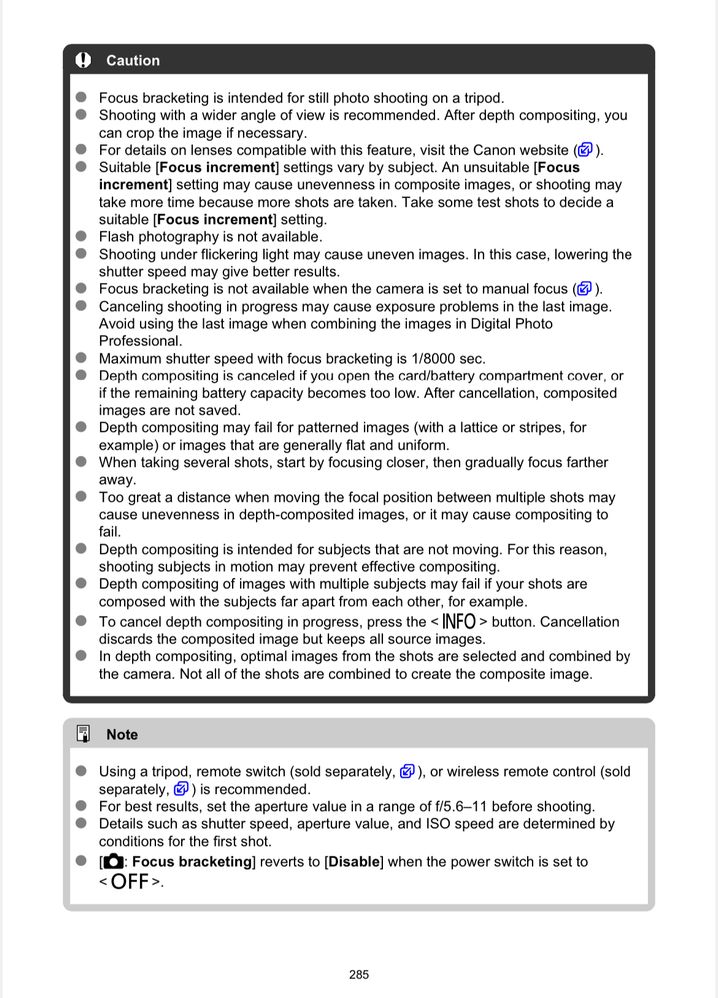

I was taking some landscape photos(more like tinkering with my new R10 purchased a month ago) with the 18-150mm kit lens and found the total images(jpeg/RAW) taken using focus bracketing does not exceed 5-7 regardless of the number I set it to, and after the shots are taken I can see specific areas of the images out of focus on all images in the stack. Tried with 12 then 20, then 32 and so on. The AEB was off by default and I kept the increment to its default 4. Saw many youtube videos with people taking the exact number of images they set the sequence to, with the exact same settings as mine. What am I doing wrong?

Have yoiu reviewed the extensive list of “Cautions”?

Thank you for the explanation. I used various settings including the ones specified. Tried shutter at 1/2000 - 1/60. f4 - f11. Different iso settings including auto. Experimented with focus increments ranging from 2-5. But all these made no difference.
About videos used as ref: Focus Bracketing | SETTINGS and step by step EDIT. (Focus Stacking)
One thing I discovered was when shooting handheld it takes no more than the said number of 5-7 images. If however I set it on a firm base like on the ground or a table(I dont have tripod.. yet), it takes the exact number of designated shots I set it to take. Is the low number of shots due to me handholding the camera?

“ One thing I discovered was when shooting handheld it takes no more than the said number of 5-7 images. If however I set it on a firm base like on the ground or a table(I dont have tripod.. yet), it takes the exact number of designated shots I set it to take. Is the low number of shots due to me handholding the camera? “
Possibly. In fact, it would seem so. Using a tripod is included on the page of cautions and warnings.
