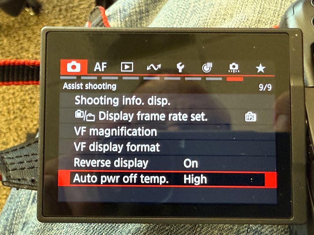

edh
Talking to another Canon photographer who also had problems with the R1 overheating while covering sports - it is an issue with the camera. He advised switching the auto power off to high. That solved the problem for him.  I haven't hit hot weather since.IMG_8361.jpeg
