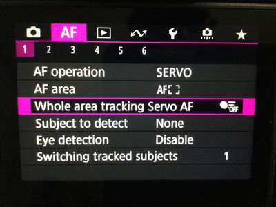

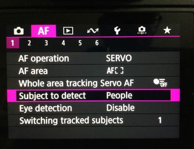

For example, I have C1 set for “bird on a branch” mode.  It’s set for One Shot AF. 1-pt AF point selection (Center).  Initial AF point is Center. Whole Area Tracking (known as Face Tracking in R5) is disabled.  Single Shot drive mode. The [AF-ON] button is set to standard BBF with the Shutter set to Metering only.
I have C2 set for “bird in flight” mode.  It’s set to Servo AF.  I use 1-pt AF with Surround AF points.  The Initial AF point is set to the Center.  Whole Area Tracking is enabled.  I use Continuous Drive mode.  The [AF-ON] button is set for [AF-OFF].  The Shutter is set to it’s default, metering + autofocus.
Both modes are defined by M mode exposure mode with ISO Auto.  The [Set] button is configured for Exposure Compensation, which allows for 3 stops of ISO tweaking.
[EDIT] Default exposure is 1/1600, f/1.4, ISO Auto capped at USO 12800.  If a lens is not capable of f/1.4, then it defaults to its minimum setting, f/2.8 or whatever. [\EDIT]
Of course, auto update is disabled, as previously mentioned.
There are a number of other settings shared by the two custom modes.  Foremost among them are the EVF settings, which I won’t bore you with detailed descriptions.
I wanted to post my R6ii settings for C1.
….and the settings for C2.m
