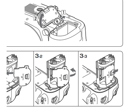

Research indicates this might be an issue with the battery door sensor. The door gets removed when you use a BG. If the door is not aligned or closing properly it might trigger the error message. The camera knows when the door is open or off. I'd carefully remove the door and inspect the area. Dirt could cause an issue too. Take a look at let us know what you find.

If you had a grip, that might help with troubleshooting:
I wish I had more to offer here. 🙁
