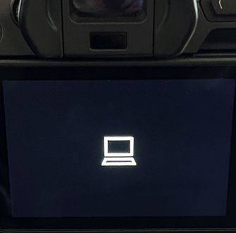

All programs are up to date, and Wifi is disabled on the camera. The camera displays this:
When I plug in the camera, I get the Windows USB sound, but Windows does not prompt me as to what to do when it detects a camera, and there is no drive mounted in the file explorer starting with Canon EOS or anything else. If I plug in my phone using the same USB port, I see it in the file explorer.
