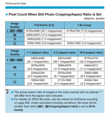

In anticipation of your reply that you have been using EF-S lenses, there is an issue with using those lenses, which are designed for an APS-C camera, as they behave on a Full-Frame one like your EOS R.
In the DSLR platform you could not put those lenses on a FF body, as an EF-S lens projects too close to the sensor and fouls the mirror. While there is no mirror on the EOS R, the image that is projected from an EF-S lens is still going to be the size of an APS-C sensor and thus will not use the whole area of the FF sensor. This causes the area covered to be reduced from 30MP to just under 12MP, which is what you are experiencing.
See P610 in the Advanced User Guide and refer to the column under 1.6 crop for the values you are experiencing.
There is no work around this except to use EF or RF (not RF-S) lenses if you want to use the full area of the R sensor.

When using EF-S lenses on a full-frame R-series camera, it will go in to crop mode. The size of the EF-S lenses are such that they cannot cover the full area of a full-frame sensor.
EF-mount lenses are designed to fully cover a full-frame sensor. So best to stick with those lenses.

The Tamron lens is compatible with a FF sensor, but the EF-S 18-135 is designed for the smaller APS-C (crop sensor) format and will not project onto the full area of the R's Full Frame sensor. To get a full image, you would need to consider something like the RF 24-105 STM lens, which is native to the R platform.

The same issue that I explained previously will also reduce your resolution for video, see P616 of the Advanced User Guide: Link in previous post.
