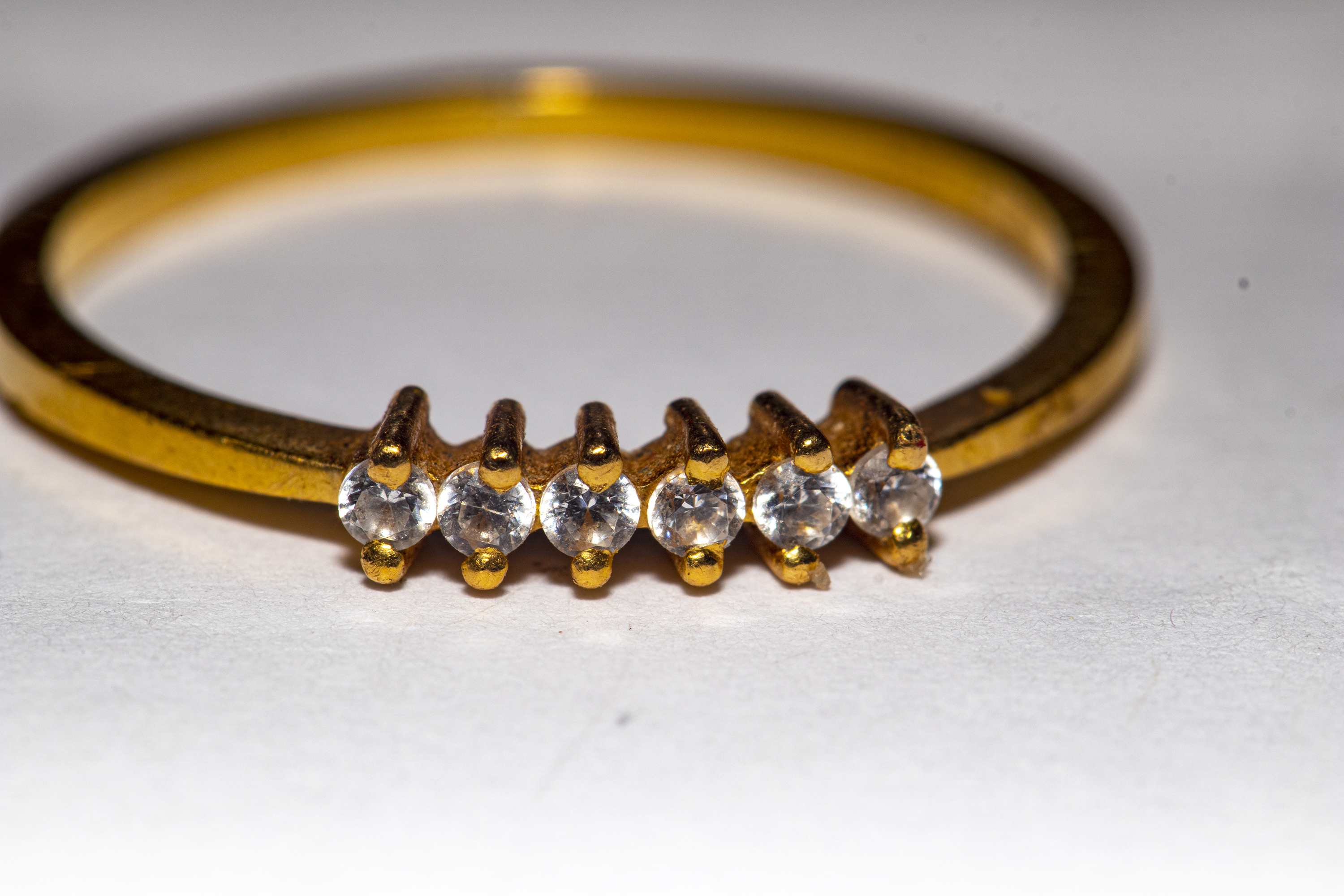

this is the maximum magnification of a canon 100mm macro lens (Not Reversed 1:1 magnification)

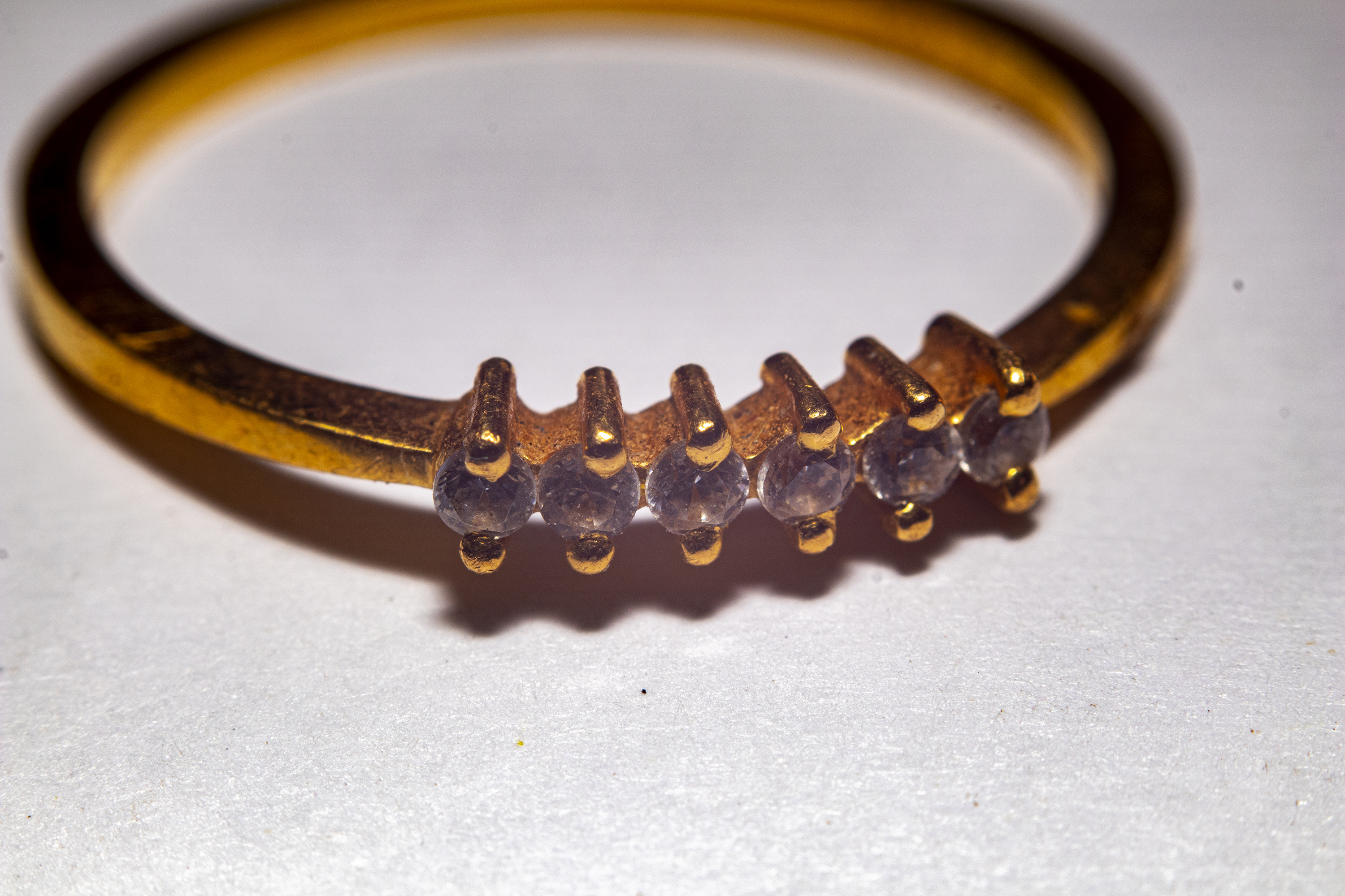

this is 50mm f/1.8 Full frame lens reversed ( wich was your sujestion)

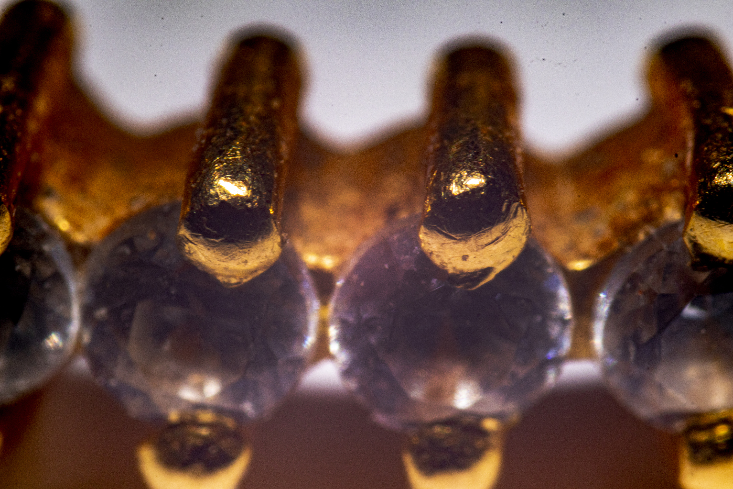

this is 18-55mm EF-S lens reversed @18mm
so, imagine the result of 10-18mm EF-S lens reversed @ 10mm
