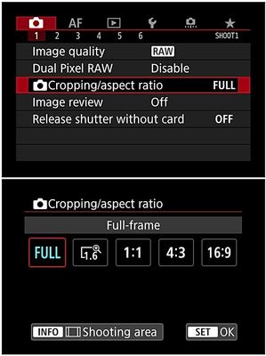

I am interested in a unique look of rounded images on a full frame sensor by using APC lenses. I want to be able to turn off crop mode when I mount an APC lens on a full frame camera. Please update the firmware to allow this.

As I understand it, the OP does not want the FF camera to automatically reduce the recording area to that of an APS-C sensor when a RF-S lens is connected - as it does now.   This is done to make the camera produce a non-vignetted image, but the request is to allow that feature to be bypassed for an artistic effect.

If you use a 3rd Party APS-C lens like Sigma or Tamron, on a Full Frame camera, the 1.6 crop has to be manually selected in the menu.  If you leave it in Full Frame, you should see the effect you are looking for.

If you set to 1.6x crop mode, I thought that it should still capture a FF RAW image.  This setting only controls how the RAW image is displayed in post.
However, ff you are saving as JPG, then the image will be saved fully cropped.
