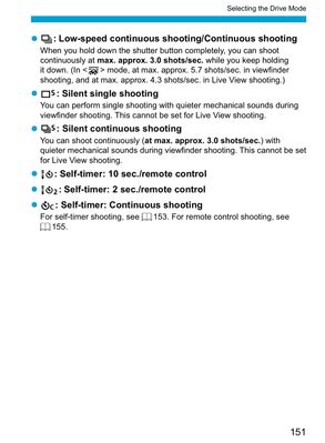

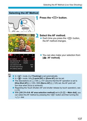

Waddizzle
As I recall, the 90D had a feature that allowed it to behave like a mirrorless camera. It must have had a mechanism that could lock the mirror in a raised position without drawing power from the battery.  The autofocus features described in the following screenshots of the 90D User Guide are showing menus that are similar to those in the R Series camera menu system.
