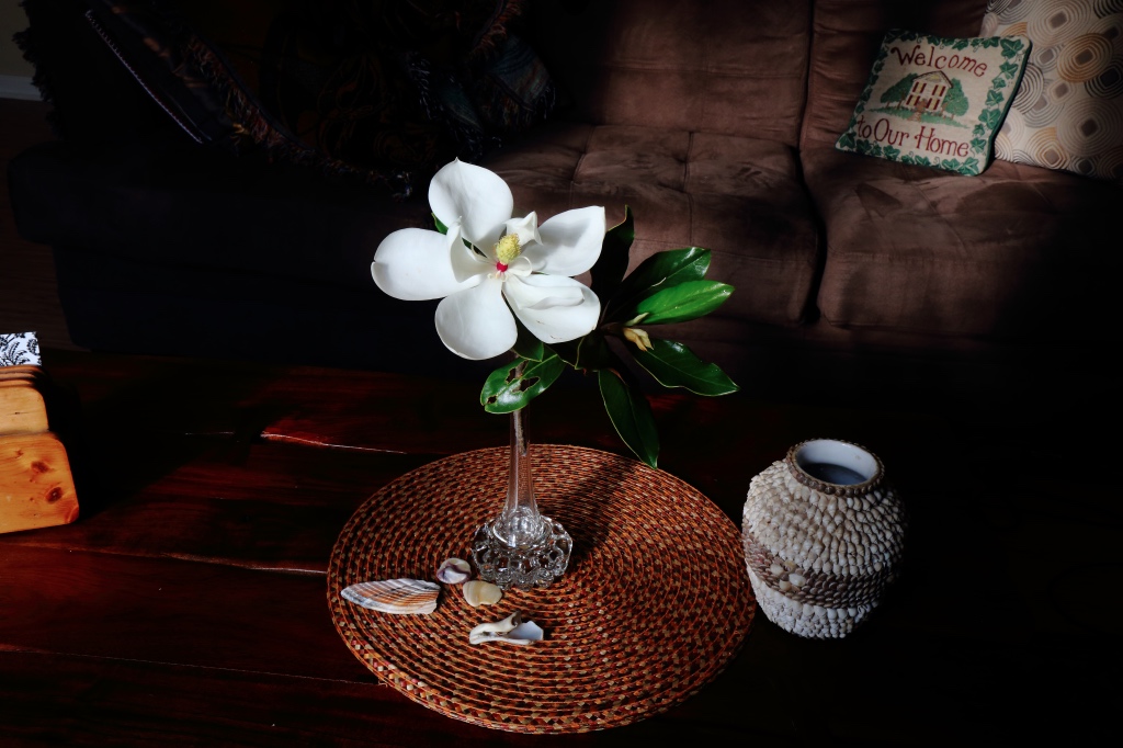

Hello Everybody. My name is Dennis and I'm a newb, not to dslr's but to this model, so please have mercy on me.
First question: When using the image processing software, PF 4 should I be able to go to 100% and still have a sharp image?
Every image I take, with any lens, whether I focus manually or with AF, seems soft to me and I can't often make it sharper in post. I use raw.
MY Iphone 8+ does fine at 100% and is razor sharp.
Next: How in the world do you get good focus on water fountains? I can't get any kind of decent focus with MF or AF.
The attached examples are resized to make size limit but to get the size limit I'm afraid I lost resolution, so there's another question.
BTW, my 10D does same thing
Dennis

Your sample images are not good examples to use for comparison because the subjects are at significantly different distances from the camera. Next time try shooting the same subject from the same distance.
What lens are you using on your 70D? Many of the lenses sold in camera kits are not very sharp. Another reason why your DSLR images might seem less sharp is DOF, depth of field, which can becomes more pronounced when the subject is closer to the camera.
Finally, what are your exposure settings for the DSLR photo? Too slow of a shutter speed can cause an entire image to seem out of focus due to camera shake by the photographer.

EF-S 17-55mm USM f 2.8 was used on both those, Although I use the 75-300mm kit lens a lot.
Both those shots were f14 1/125 ISO 100. All on tripods using remote release.
I can't even think about any faster shutter speed because of either shady or cloudy conditions.
I can stop to f 22 but I end up with 1/4 or 1/8 second and iso 800.
I was trying handheld landscapes the other day at f8 at 1/60 iso 500 and everything was blurry. this is both with MF and AF.
I wanted f20 for DOF but that yielded insanely slow shutter speeds.
Auto mode is worse.
Dennis

For the settings you stated your shots are typical. I really don't see anything to complain about. ANyway as far as sharpness goes. Your orchid is OK but the hibiscus is over saturated as is the whole shot.. A common mistake for new folks. Ease up on the sliders in post.
The Canon EF-S 17-55mm f/2.8 IS USM Lens is a great lens. The 75-300mm is more of a challenge to get super sharp photos with. You are using One shot and just the center focus point? Raw file format? P mode or my choice for this type work Av mode. "Auto mode is worse." Put a small piece of black electrician's tape over that selection on the mode dial so you never even think about using it again.

Yes, One shot center focus point, Raw. Yep I did tweak sat up a bit. Use M or Av mode. Auto is awful.
Here are a few more maybe you can see the focus issue on them all. Exif Jpeg, I use canon DPP 4
Flower is f8 1/10 iso 200, Water is f4 1/160 iso 200, Turtle isf14 1/100 iso 640

You used manual focus and you missed it. Simple. Plus I suspect you cropped heavily.
Photo number 2 is probably too close.
Question, on the turtle you selected f14? That seems odd and makes me think there could be other 'odd' things going on?
A SS of 1/10 even on a tripod requires careful attention.
First I want you to do a full factory reset of the camera. Menus, tools, clear all setting and clear all custom settings, too.
OK, back to square one.
Set your camera back to P mode. Set ISO to 200. WB on auto or daylight. Put your 17-55mm f2.8 lens on AF. Go outside on a nice bright day and take a few shots, a dozen or so, that have good contrast in them. A fence, play set, or trees, etc., in a park for instance with nice blue sky. No excessive editing or cropping allowed! Lens correction only. If these shots look nice and OK, there is nothing wrong with the camera/lens. The issue lies elsewhere.
Get back when you do this and report. We have to eliminate the gear and this is how.
