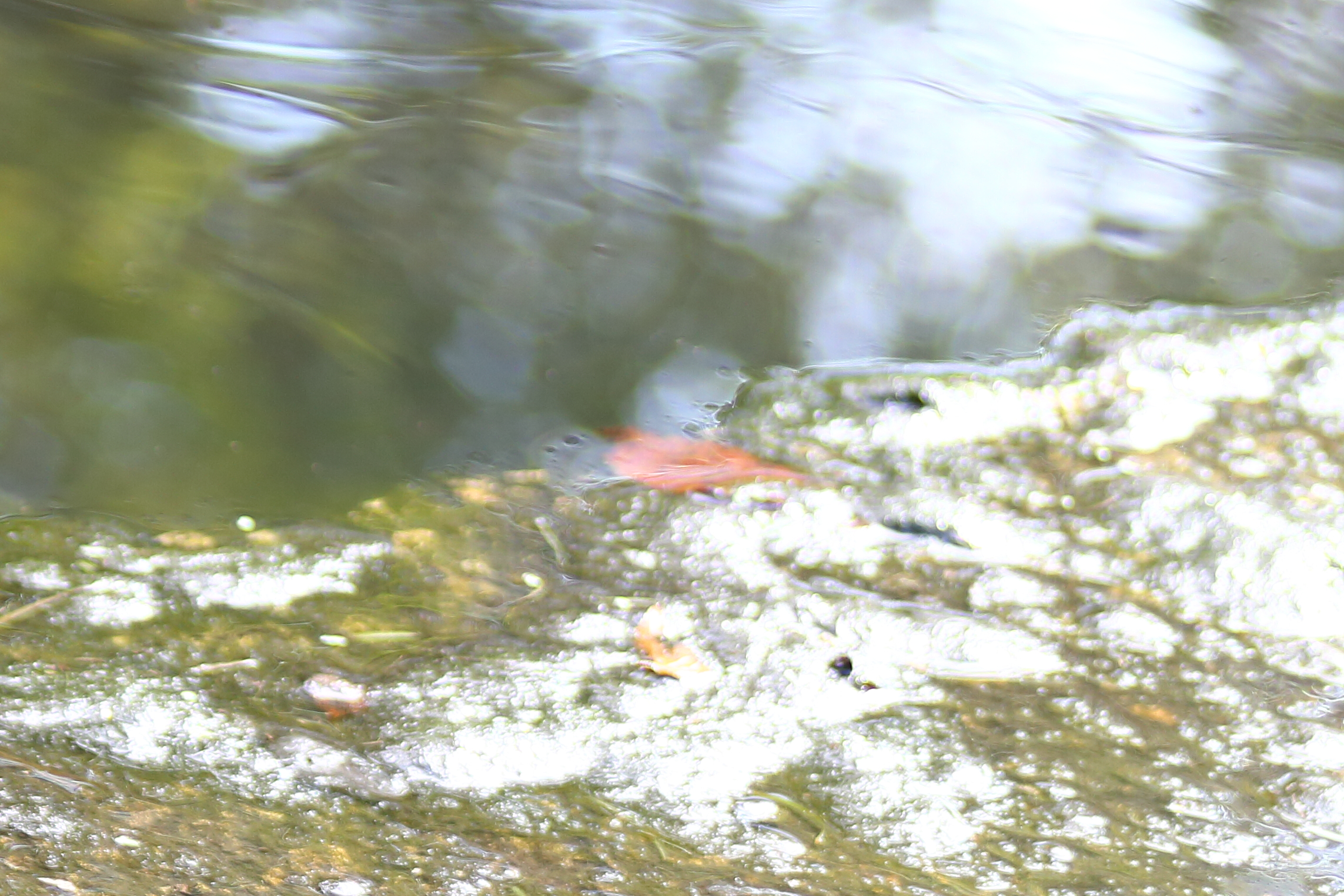

Hello Everybody. My name is Dennis and I'm a newb, not to dslr's but to this model, so please have mercy on me.
First question: When using the image processing software, PF 4 should I be able to go to 100% and still have a sharp image?
Every image I take, with any lens, whether I focus manually or with AF, seems soft to me and I can't often make it sharper in post. I use raw.
MY Iphone 8+ does fine at 100% and is razor sharp.
Next: How in the world do you get good focus on water fountains? I can't get any kind of decent focus with MF or AF.
The attached examples are resized to make size limit but to get the size limit I'm afraid I lost resolution, so there's another question.
BTW, my 10D does same thing
Dennis

Yes, One shot center focus point, Raw. Yep I did tweak sat up a bit. Use M or Av mode. Auto is awful.
Here are a few more maybe you can see the focus issue on them all. Exif Jpeg, I use canon DPP 4
Flower is f8 1/10 iso 200, Water is f4 1/160 iso 200, Turtle isf14 1/100 iso 640

You used manual focus and you missed it. Simple. Plus I suspect you cropped heavily.
Photo number 2 is probably too close.
Question, on the turtle you selected f14? That seems odd and makes me think there could be other 'odd' things going on?
A SS of 1/10 even on a tripod requires careful attention.
First I want you to do a full factory reset of the camera. Menus, tools, clear all setting and clear all custom settings, too.
OK, back to square one.
Set your camera back to P mode. Set ISO to 200. WB on auto or daylight. Put your 17-55mm f2.8 lens on AF. Go outside on a nice bright day and take a few shots, a dozen or so, that have good contrast in them. A fence, play set, or trees, etc., in a park for instance with nice blue sky. No excessive editing or cropping allowed! Lens correction only. If these shots look nice and OK, there is nothing wrong with the camera/lens. The issue lies elsewhere.
Get back when you do this and report. We have to eliminate the gear and this is how.

The 1/10 shot was MF using live view X10. inside with bright defused white lights, on tripod and released with external release. If there was shake in the system I don't know where it came from.
The focus on the flower was dead on but clearly not. I have no earthly idea how I could get it focused better as AF was worse.
they were all cropped to get the size down for the 10mb limit here.
The turtle popped up while I was shooting landscape using f14 for DOF and all I did was refocus quickly. Idealy I would have used maybe f4 for that shot. The landscapes seemed fine although any blowup at all in post shows soft to me.
I'll try resetting and shooting some stuff in the AM.
I just read a review of these xxD camerias and it found the image quality and sharpness no better than an 8 out of 10.
Maybe what I'm fighting with by expecting more but you'd think at this price I'd get something at least as good as an iphone.
Dennis

Is this shot in focus to you?
The DoF is blurring the background. The closer you are to a subject, the longer the focal length, the narrower the DoF.
