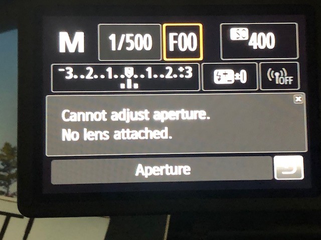

Thanks for the reply--I should have mentioned that I tried it in Manual. I can focus using the microscope controls and I can set the ISO and exposure time. The Aperture value, however, displays in the viewfinder as zero dot zero; and even though the shutter is set for 1/250, it stays open for about 20 seconds. I'm thinking that theoretically the aperture is f/1?
With this camera, am I going to need an adapter ring with electrical contacts in it to provide the needed inputs?

On most Canon bodies, the aperture displays as "F00", not as "zero dot zero" as you have described.  Can you take a screen shot of the camera display with a cell phone or something that shows that display?  Do you see it when you press [Q}?

I should have typed "zero (dot) zero" as there is not actually a decimal point, just some extra space [photo].
I can choose the shutter speed in Manual mode by using the scroll wheel near the shutter release to move the exposure "needle" to the center of the scale.
Looking at the Quick menu, there's a screen for setting aperture manually, but no action is possible.

The message is normal.  There is not aperture control available. I recommend using Live View mode with ExpSim enabled.
Didn't find ExpSim in the .pdf, but LiveView shooting works--not with the Video/Still knob, but by touching the Start/Stop button in the center of the knob, the mirror is raised. In Manual mode it allows the shutter release and uses the focus and exposure time I selected. Touching the Start/Stop button a second time returns the mirror down. Thanks for sending me back to study that.
