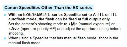

10-17-2024 08:54 AM
From the 70D manual:

Old EZ Series speedlites use an older version of TTL flash metering called A-TTL. This form of flash metering is incompatible with digital cameras. The flash will fire at full output only. Some EZ Series speedlites can be set to manual mode. But these speedlites cannot provide E-TTL Auto flash exposure. They only will work fully automatically on an EOS film body. To gain full compatibility you must use an EX series or EL-1 & EL-100 speedlites. On an EOS digital camera. A-TTL was replaced by E-TTL in 1995 with the release of the Elan II/ 7 film body.
