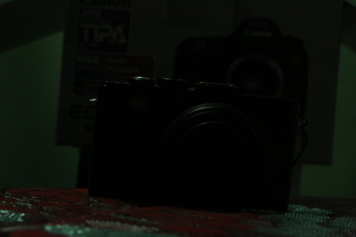

I have shot and attached a video to show you all how my camera's metering system work and result pictures. I have set the ISO 10000 according to my room's light. Here you can see it (Sorry for the quality).
Please view and suggest me what should I do.

Thanks for posting those images with EXIF data intact.
I recommend you contact Canon service to arrange for repair. Your "meter" believes you are receiving an extreme or possibly infinite amount of light and isn't just metering high (and underexposing by a stop or two.)

Your first shot is a "manual" exposure.
You used:
Manual
1/12 sec
f/4
ISO 10000
You would have to pick all of these settings.
Your second shot used Aperture priority. This means you get to pick the aperture, the camera will pick the shutter speed.
Aperture priority
1/8192 sec <- camera picked this value
f/4 <- you picked this value.
ISO 10000
As you can see, the camera pixed the fastest shutter speed possible. I suspect it would have chosen an even faster speed if only it were possible.... but 1/8192 is the limit for that camera.
Your third shot used shutter priority.
Shutter priority
1/21 sec <- you picked (you probably picked 1/20th but it got rounded by the EXIF data)
f/22 <- camera picked this... but note the high f-stop value. That's the smallest available aperture on the lens.
ISO 10000
As you can see here, the camera tried to constrain the light as much as possible by setting the smallest aperture opening (highest f-stop value) the lens can provide.
And that brings us to your final example... Program AE
Program
f/22 <- camera picked this value too
ISO 10000
As you can see... everytime you give the camera control over the setting... it does everything it can do to cut the light.
This is not merely an example of exposure compensation being a stop or two below standard... your camera thinks it needs to do everything it can to reduce the light. It's as though the meter believes it is getting an infinite amount of light.
This is not a camera setting we can "adjust" (we can control the meter within a few stops). This is an issue which would need professional repair.
