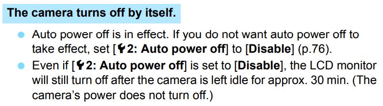

We saw your message about this being marked as spam - it could be related to your username. If this continues to happen, we might want to look at changing your username to something that won't be automatically filtered - just let one of us Moderators know, and we can help you out!
Regarding your 5D Mark IV "going to sleep," try the following:
If this doesn't help, reach out to support at 1-800-OK-CANON (800-652-2666) weekdays from 8am to Midnight (ET) or Saturdays from 10am to 8pm (ET).
